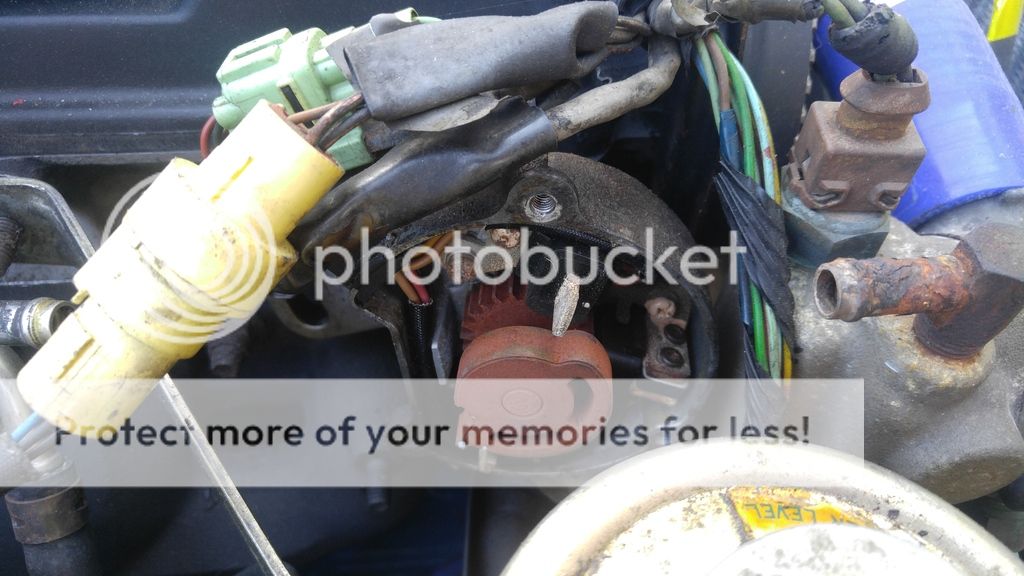

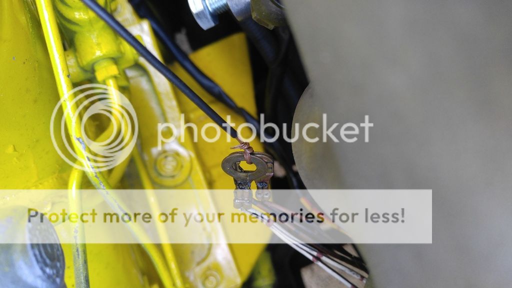

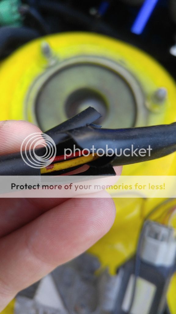

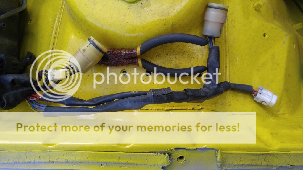

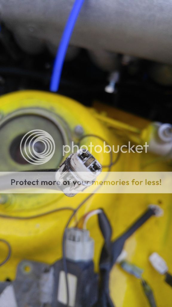

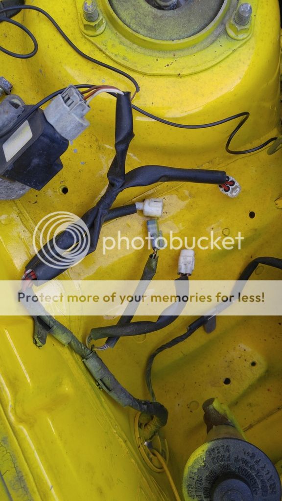

I am new to the forum and hope im posting this in right place but I am in desperate need of help. I took out my 7m engine to clean it up and check it out while doing a head gasket (plus whatever other gaskets i could reach) and when I went to put it back in I have no spark. It tries to kick on and I have fuel supply but it wont fire. I have trouble shot the plug, cap, wires and cps with no luck. Now I cant figure out what 2 wires go to after reinstall. The wires are pictured. Also I "deleted" a bunch of excess stuff that didnt look important....if I deleted something important please tell me. Thanks for any help.

That's definitely not a good ground fix on the last picture, those bolt to the underside of the intake manifold towards the firewall.
A lot of times with the old wiring harnesses especially by the cps, they get hot and brittle. Try wiggling the cps wires while cranking. Not the plug wires, cps wires.
Also, put your coolant lines back on otherwise you'll overheat and blow another hg. A lot of the wires can be traced on the tsrm, a quick Google search will bring that up.
What all did you delete?

How can you tell what it important or not by just looking at it? What exactly did you remove? Did you simply disconnect everything or did you install dummy resistors or something?
I think your first picture shows the fuel pump relay and resistor disconnected. Did you delete those?
Beyond that I think we need to know what you deleted before we can be any help. If you can, put it all back together and don't delete anything until you know exactly what it is, what it does and how to properly remove it without disabling other valuable functions.
98 Posts
Just from the pictures it looks as though you may have deleted the resistor for the injectors drive side fender well square box with a round plug yellow plug coming off of it if memory serves me right. Wouldn't cause no spark but it would cause the injectors not to fire

when did you do the head gasket, how is that exhaust stud/nut so friggin rusty already (pic two)? if you just backed the entire stud out b/c the nut is seized on, your about to have a nice exhaust tic/tic/tic.
