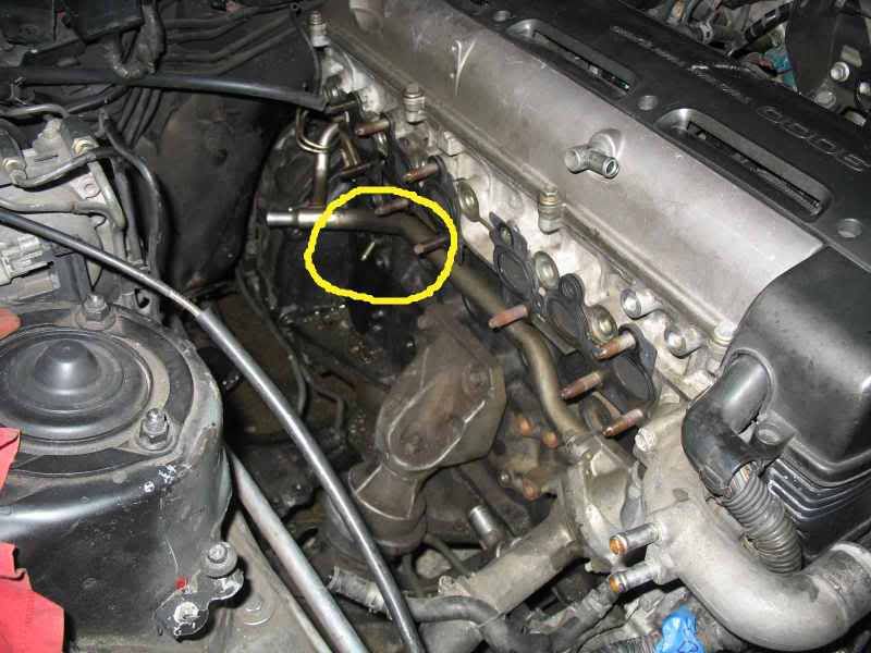

Well, I pulled the twins off last night and noticed a small tube near the back of the engine block down next to the oil supply line for the rear turbo. It didn't have anything connected to it. I thought maybe it's a block drain but wasn't sure. Any one shed some light for me???
963 Posts
i believe its a coolant nut.
I opened it up a couple weeks ago and i got coolant out of it.
The coolant was old stuff too. I drained and filled with toyota red, and when i opened the nut, the cheap green coolant came out.
correct me if im wrong
Sorry i was referring to the nut. I dont think my car has that nipple there, maybe its on certain years

670 Posts
water... you need to close it off... I put a vaccum cap thingy there.. Doesn't your turbo have a place to pull vacum on the compressor? if not there's one on the intake manifold, that will do....
