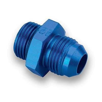

that Earl's part has different ends...if this is actually the part you have
one side is 37deg -10 flare the other is -10 SAE O-ring boss, but the threads are both 7/8"-14 See this page: http://www.jgbhose.com/base_pages/coupling_identification.asp
