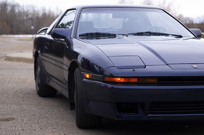

that goes on the front of the car between the bumper and the upper nose peice?
See the grill style stuff between the front 2 blinker/marker lights, My style only had the 2 small peices on each end but my body kit no longer has that bump in the middle

That's the grille..
Pre 89's had one big one, and 89+ had two.

Just so you know if you have a 89+ and now have an pre 89 style bumper and want to switch the center piece you will also need to swap the turn signals and will have to do some modifying to get the pre 89 signals and pre 89 grille to fit. In other words its not a direct replacement.

you can swap the metal header panel support, and it'll work fine.
I have a pre 89 header panel support on my 92 with pre 89 euros. Shit's baller..
Supra Hoarder...
958 Posts
ive got a 92 using 87 nose cone support with 92 bumper with 87 half amber half clear euros with modified 92 smaller grilles
exactly what I'm running, same years too..:D
