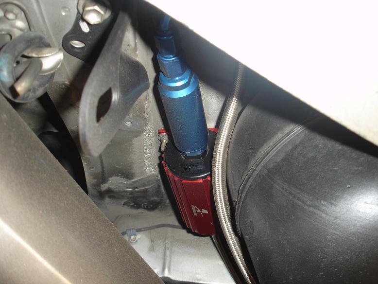

Well, this is what I did, you guys think this is an OK spot?

It's a clean install. I just think it's a little too close to the exhaust.
I would be more worried about the gas tank. It is much closer and made of plastic.

Yes it is ULTRA loud, but I had to get it mounted fast. I was going to mounted it with rubber isolators later. I will be making a bracket for my Weldon since it can't be mounted like the A1000. Maybe I can find a different spot since it is slightly different design. Still about the same size though.
That isn't a good spot for an Aeromotive pump. It is mounted too high and the life expectancy will be shortened along with possibly creating vapor lock issues in warmer weather/stuck in traffic conditions. It needs to be mounted similar to the picture Duane posted to live a long, happy life. The $$$ Weldon isn't so picky but is even louder that the Aeromotive. It sounds like a starter motor is running, bouncing around in the trunk when it is on 12v.

Well, I removed the A1000 last night. I will probably mount the Weldon in the same place, and yes, Weldons are self priming, and I don't believe require fuel for cooling. I used it to drain 10 gallons of fuel out of my tank though, man that thing pumps a lot of gas, and it is a lower pitch than the A1000. My bracket is using rubber isolators. I have to re-do my pickup tube. I thought it was 1/2" ID, it is only 3/8".
Do you have a filter AFTER the pump along witt the filter u have BEFORE the pump??? Also, did you mount it below the tank? I wouldn't have the pump hovering over the exhaust system either. Get some thermotec if you intend on keeping it in that location!
