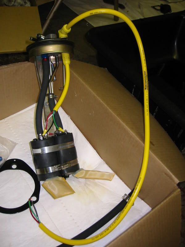

I am looking to buy a dual DENSO (oem) pump hanger setup. I DO NOT WANT WALBROS! Who makes a setup for dual denso pumps that I can drop right in and go?
I saw this person made a pump setup which looks super clean, but I think he made it himself. Any info is appreciated.

My dual Denso fit the stock hangar fine.. And that looks like a Titan motorsports setup except for the wiring.
My densos fit in the stock hanger after the Titan fuel system install but now the floater in the gas tank is caught on something(s) and the gas gauge is off, I'm going to have to take it back out.

call titan ..they are doing mine with dual denso pumps right now
