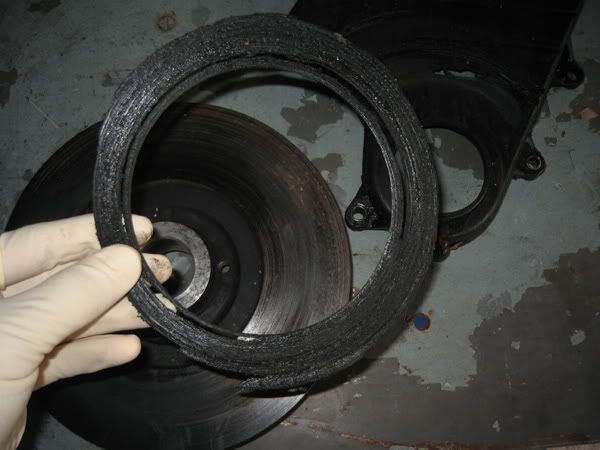

The crank pulley on my JDM GTE motor appears to be a little wobbly. It was hitting the front cover pretty good and melted it. I don't think it's just from the cover being loose because it looks like the pulley has more wear on one side than the other. Is this a common problem? I'm guessing I should just replace the pulley?
3,688 Posts
Definitely replace the pulley before it actually separates and ruins something. Go with a Boost Logic Crank Pulley.
