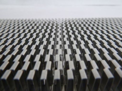

The first thing you want to check out is the fin pack design. An offset and staggered fin design will be your best bet in dissipating heat. The straight through fin design will pass the air right through like a tunnel, the offset and staggered fin pack breaks up the air molecules and forces the air to come in contact with multiple fins creating a denser charge air.
** ETS Offset and Staggered Fin Pack

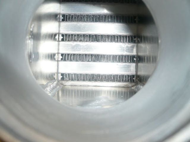

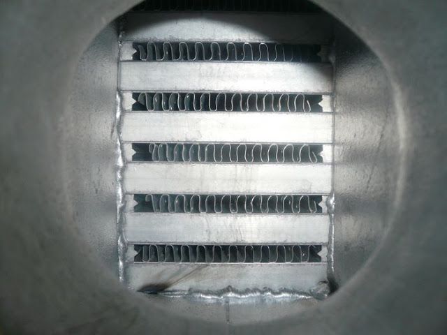

** Ebay Core (Notice how the air flows directly through the intercooler and not off the fins)

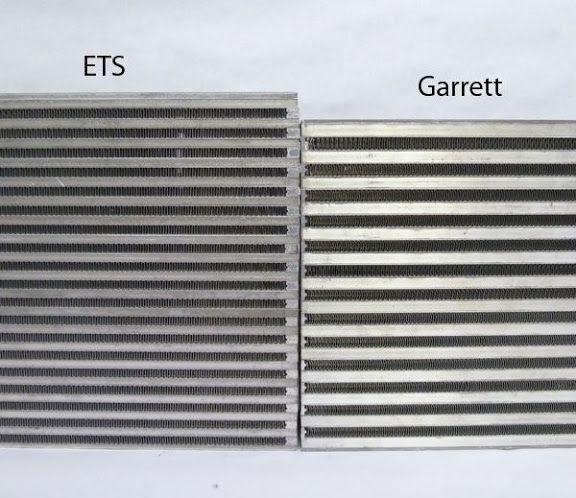

** ETS Core VS Garrett (We do something a little different here by changing the size of the charge row to give us more heat transfer plates. If we have an extra 4 charge rows over the competitor core in the same area we get 8 extra heat transfer plates. This is the top and bottom plate of the charge row. By doing this we can loosen up the internal charge rows which gives us less pressure drop and more external heat transfer area.

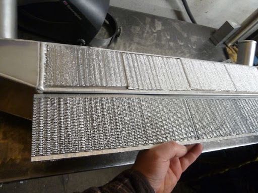

Here is a picture of the Garrett core that we cut in half to make a smaller SRT-4 intercooler. The internal results of the Garrett core were a bit disturbing. The core doesn't look like it would flow too well.

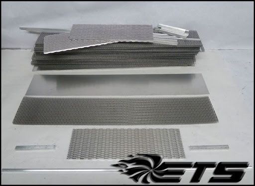

** ETS Intercooler Core Components
