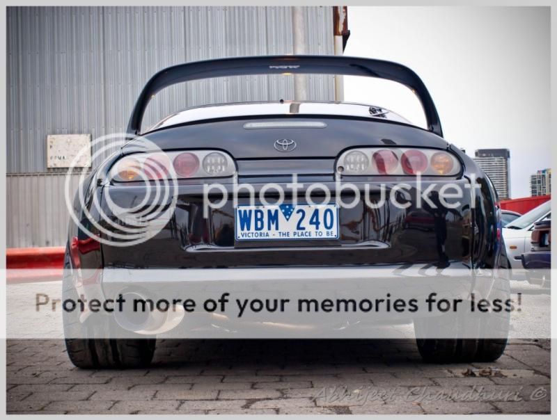

One exhaust i have always been fond of but simply can't find anywhere is the AB-Flug exhaust...
I dont remember the user that owns this exhaust system and i apologize if he sees this for not naming him.
But yeah this exhaust system is so amazing to me i would literally pull off my blitz right now just to own this .. I've searched all around and it seems like awhile ago this was a popular exhaust only in germany... But i can't find any website ever after hours of searching that sells a system like this. Not even a used one.

What's special about it?
