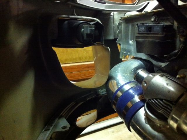

I believe the latest model of the SSQV (4th gen) is made to withstand more boost then earlier models due to having 2 valves in the unit now. I could be wrong but after doin research that's what Iv come up with. I plan on adding one on my setup along with my HKS Type 2 racing bov located under the driverside headlight/brake duct area. Im going to put the new bov on the opposite side so you can see both of the bov's in both brake ducts.
