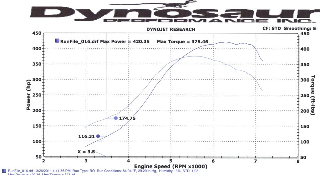

Just got off the Dyno Numbers are in!
8.2K views 36 replies 18 participants last post by  gilberjj
#1 · (Edited)
Made 420WHP at 23PSI ran out of fuel. Was on 92 octane pump gas. Got to start looking at how to break 500. Tuner said with a Bosch 044 Pump and Race gas i could Defiantly break 500 close to 600 but i don't want to mess with race gas. Im am looking in to my options. Car is currently running at 385WHP at 14psi but getting the boost controller installed and will crank it back up. Mods in the Sig

Seems like you should be making quite a bit more than 420 at 23psi to me. I made 426WHP at TX2K11 with 18psi-93octane, 440 injectors , stock ecu, SAFCII, Walbro pump, aeromotive regulator, 2.5" intercooler piping, 60-1 Driftmotion single kit.
Which 3" exhaust are you using and are you using a test pipe or cat? I noticed with the Blitz Nur exhaust that the flange that seals to the cat/test pipe the flange tapered down to around 2.75". I beveled every input flange in the exhaust to cut down on turbulance and grinded/filed the 2.75" out to 3". Before doing that I made 371WHP at 18psi.
I am just curious but I have always heard not to go past 18psi on pump gas, without methanol that is. Just wondering if you or your tuner had a way to monitor knock. To run that much boost with pump it seems your tuner must have had to pull alot of timing. My thinking is that less boost and more timing would have yielded similiar power, might create more heat though. I AM NOT a tuner, I just want as much info as possible, I am also trying to make more power and about to go stand alone.

Something is certainly not right. Food for thought - my stock 1jz(only mod is cams internally) did 640rwhp at 24psi with a smaller turbo(t78 66mm compressor) and a haltech with my amazing-moses like-nay-god like-tuning abilities. LOL, j/k...but no seriously. Either you have a boost leak, your tune is realllly bad above that area or your turbo is horribly inefficient. If the engine is sound and happy, the turbo is fine and isn't some bastard housing/wheel combination, no boost/intake leaks then I would be pointing my big hairy pointer finger at your tuner.
Also, I see you have 1000cc injectors (I am using 850's for what it's worth) if it's available and feasible with your driving style - I suggest you go with E85. You have enough injector for twice the power your making, BUT one walbro is screaming bloody murder near 500rwhp.
P.S. With all that being said, Don't expect much over 500rwhp reliably on 92 pump without adding meth/water.

The fact that you have a AEM leaves a lot on the table if your tuner sucks. If you can send me your map I can tell you if thats a variable.

Finally made it back to the dyno today. Got a new 1JZ short block and put the motor back in the car last year. Got it out of storage the other day to finish. Anyway i still think something is wrong.
After spending all day at the on the Dyno and another $600 im kinda disappointed.
I only made 335whp at 15 psi and 389 at 18.5 psi all on 91 pump gas.
What is the problem here i honestly thought i would be at the 500 mark on 18psi? My mods are in the sig and input is appreciated.

your tuner sucks. even thought im on a 2jz, i made 384rwhp and 391rwtq @17psi. this was with a major boost leak and boost dropping down to 14psi. my mods are precision 6262 t3 with a t3/t4 adapter, 3in exhaust, fmic with 2.5in piping, and microtech standalone. and this was on a half ass street tune. even though im .5 liter bigger, you should be way above me because you have a much larger turbo, and twice the fuel. your tuner isnt doing something correctly

What type of dyno was this on? When i had my 1JZ I dynoed 480whp @ 20psi on a dynojet. Then a few weeks later dynoed 430whp @ 20psi on a Mustang dyno.
#35 ·
DynoJet at Dynosuar performance in ft worth
