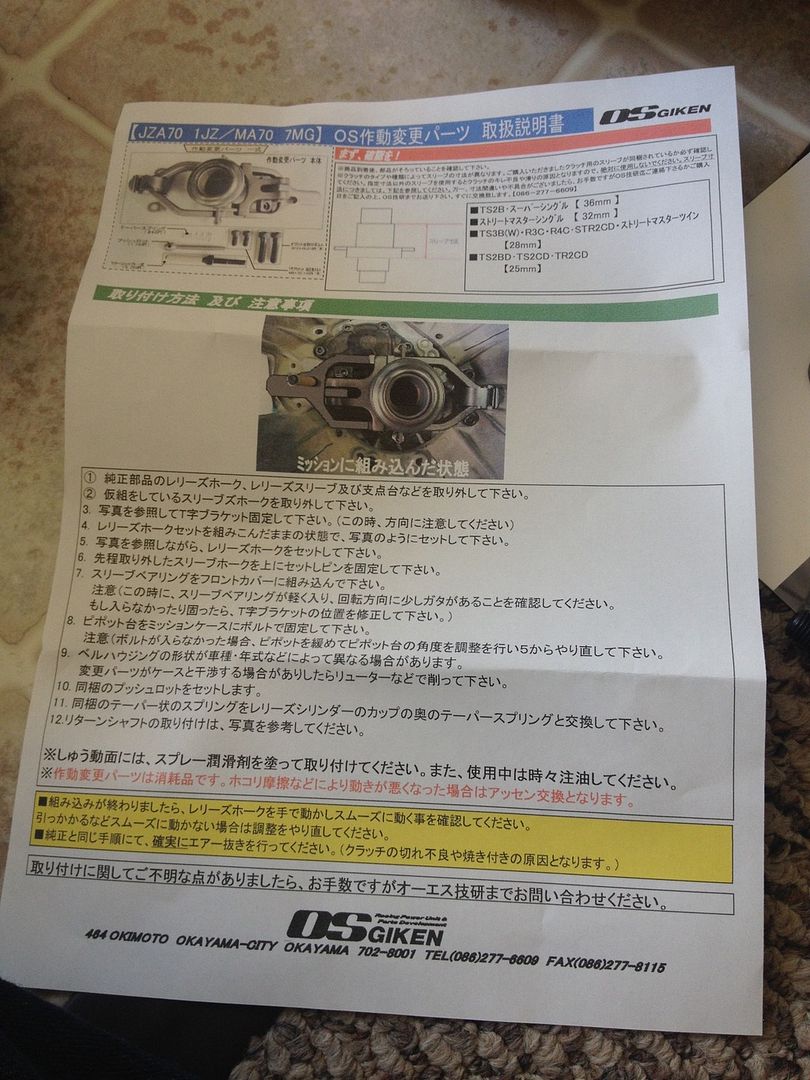

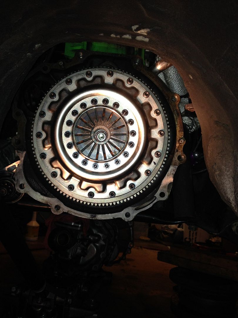

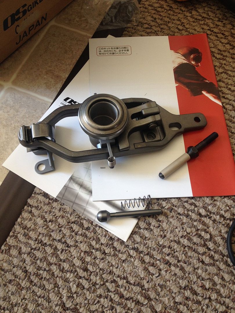

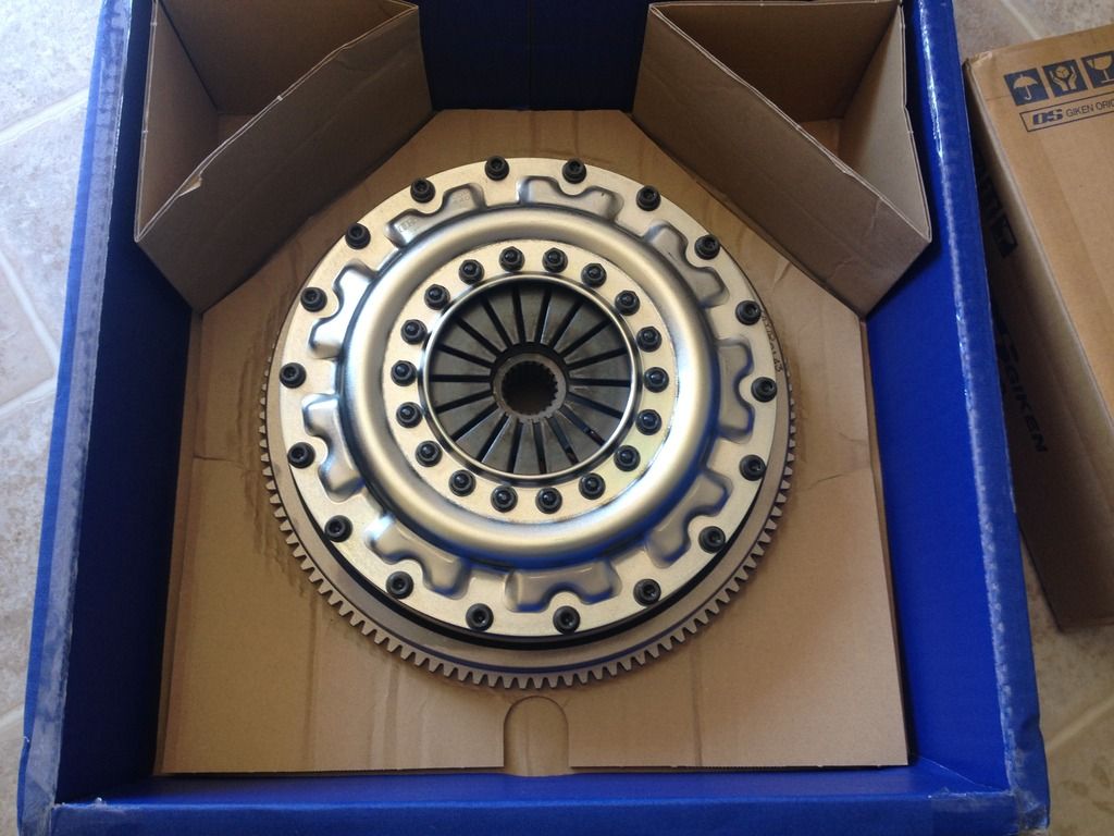

figured id update this post. i finally got my clutch this past friday. there was a hold up with customs but rhdjapan was fast to sort out the issue and get them the paper work they needed. was something about a more detail description of goods. it was like Christmas though i was pretty excited been waiting for a while to get it lol. i worked on getting it installed that evening i pulled my trans earlier that week cause it was suppose to show up wednesday so i had a head start. the directions were all in Japanese which made putting it in fun!
i was a little confused on the movement alteration kit. there was a cone shaped spring that i couldn't figure out what it was for at first. lots of the pics of the kit on the r154 theres a return spring on the guide pin so thats what i thought it was at first. in the pic on the instuctions i thought maybe it went on the back side of the pin. then ended up finding a thread where some guy was confused also and contacted os giken and in the updated version theres no return spring on the guide. the cone spring goes on the new slave cylinder rod im guessing to help keep it centered.

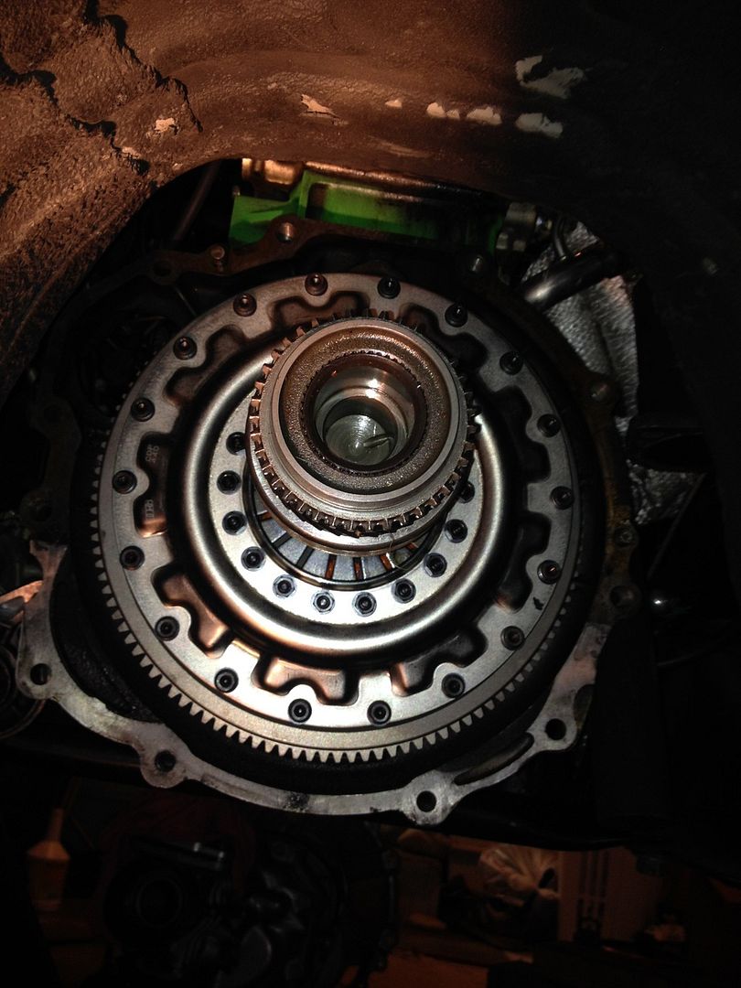

in the clutch directions i could tell by the pics that they were showing the flywheel bolts needed to be cut down. i put the flywheel on with two bolts and checked the depth. it was really close to the length of the arp flywheel bolts i had on the stock flywheel so i cut them down a little to make sure they wouldn't bottom out.
then i wasn't sure if i was suppose to put it all on the input shaft like how you normally install the trans but then came to the conclusion keeping all the disks and plates together would be a total pita plus torquing all the bolts down for the pressure plate in multiple passes o_O so i figured it had to be installed like most push type clutches. the clutch doesn't come with an alignment tool either but luckily i had something handy that would get the job done. i knew i blew up that trans for a reason lol
to get the trans in i had to jack up the front of the engine that way it angled down more to get the input shaft in. without doing that the bell housing hit the trans tunnel. was quite the ordeal but i got it in friday and wrapped it up saturday morning.
when i first backed out of the garage i like shot out of there cause it engaged so hard and i wasn't used to the engagement point at all :lol: it was cool though cause it didn't chatter at all or feel harsh engaging just really quickly engaged and made the the car freaking move! i pushed the clutch back it right away though to keep me from ramming my neighbors house hahaa. i drove the car around all day through the local towns trying to start from a stop as much as possible to get used to it. then later that evening went to the local street legals to make a couple passes. im sorta bad at waiting for breakin periods lol. but i don't think metalic clutches need much of a breakin. i only made like 4 passes i think 12.3 was my fastest they weren't printing out slips so i had my friends looking. was able to run 18psi though and it didn't slip at all pulls pretty good too. the pedal is a little stiff but nothing crazy and i got used to driving it for the most part. and it doesn't make much rattle noise at all with the clutch in. you have to really try to hear it or be in a enclose area. so thats nice. seems like my trans shifts a little better now too. im happy with it though and now when somebody else gets one they can know how and what to expect with the install.
