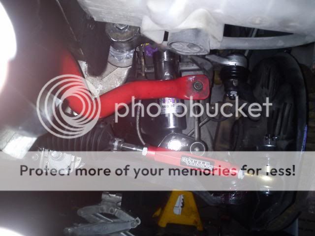

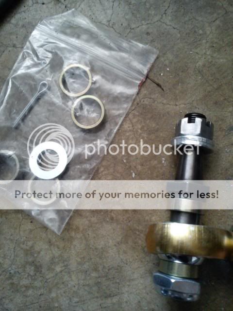

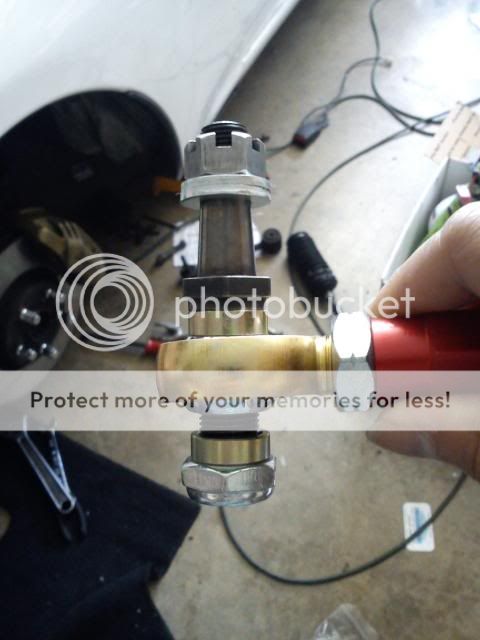

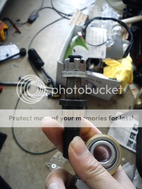

Bump for an older thread. I got my Battle version outer tie rods, so here are some pictures of them, though I can't give my feedback until my car's back on the road with the alignment dialed in.
In the pictures below, that's how I got them out of the box. There's a gap between the spacers and the joint because the bottom nut isn't tightened down, just to save everyone the confusion. In the seperate bag, are the spare spacers which you can swap to heighten or lower the tie rod.
Here's a pic of it installed, I currently have the largest spacer on top and smallest on the bottom, so we'll see how it does.
#18 ·
Today I just got my car back together, so I'll report back one more time. I started getting the alignment dialed in at the alignment rack, and on my way to the shop, the car wandered like crazy due to just about everything being off, but the bumpsteer wasn't too bad. Granted my ride height, I started off with the Lance's alignment as a base, but still ended up with about -2 degrees of camber give or take all the way around. I had about 1mm of total toe in the front and rear if I remember correctly. The machine didn't read my caster angles, although I have those eccentric bolts currently maxed out positive. I still need to go back to do some more tweaking tomorrow, but so far I'm not experiencing any major bumpsteer or wandering issues at all. Mind you, this is on a 285/35/18, and 315/30/18 tire combination.
